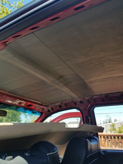

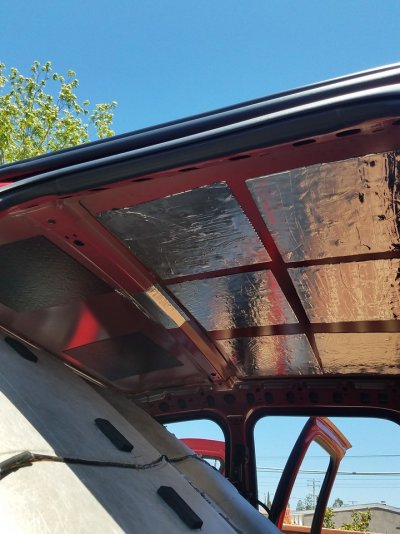

Dunno. But here's what you can take to the bank: ANYTHING you do is going to be better than what you have today. One of the advantages of having 3 layers of application is because the surface may not take the thickest of products. For instance, I put 1/2 inch Dynaliner on the back wall, but that wouldn't work for me on the roof or the doors, so I went 1/8 and 1/4 inch respectively. Also if you're interested in chasing the heat out of your cabin, you'd do well to really focus on the firewall at your feet, and the roof.
The biggest bang for the sound buck (quietness) I achieved was after doing the backwall and the doors. Everything else was gravy. I spent well, well past $750, but I really don't regret it one bit. Every single time I (or anyone) gets in the truck, it is the most pleasant experience.
