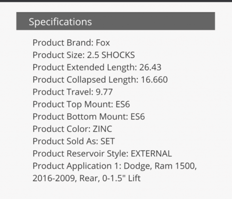

In the rear, I should be pulling just about 13" using a 1.33 to 1 motion ratio and the 9.77" of shock travel and just over 9" in front using a 1.6 to 1 motion ratio with the 5.77" front shock travel! :) Pretty sure the motion ratios I used are accurate although somebody please correct me if I'm mistaken. I think that my shocks have a little more actual travel due to having the external reservoirs than a similarly specced non reservoir shock?
This sounds about right. The rear is harder to calculate off hand since it's based off shock angle vs travel in a given distance. But i would suspect it's around the 1.2-1.3:1 range and the front is for sure 1.5-1.6 range. My memory is a bit vague on what exactly they were but ballpark is right in those ranges for sure.
Having the external resivoir I believe does add a bit of stroke vs IBP shocks. Yet again I haven't nerded out in a while on it. Strictly going to a higher volume of oil and getting the gas into the resivoir instead of sharing the shock body is worth it. My rear fox 2.0s are 16.6-28" spec and they get hot quick. Even with this amount of travel the rear can't keep up with my front simply with it being marginal valving profile and a small body shock.
With your setup you'll be able to boogie no problem. What kinda valving are you going with?
I am going to have them ride super plush with the ability to stiffen them up with the DSC's when hitting rougher terrain. Unfortunately I don't have anywhere too hardcore to drive where I live but even washboard roads can test our suspension pretty good.

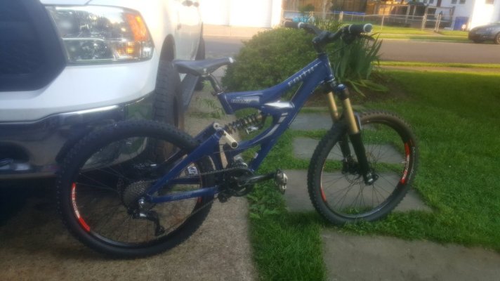

I haven't ridden in a number of years now as I went through some health issues. I was riding a custom hand made frame made by a guy out in B.C. and my suspension was by the company Avalanche. DSC03876.jpg

I haven't ridden in a number of years now as I went through some health issues. I was riding a custom hand made frame made by a guy out in B.C. and my suspension was by the company Avalanche. View attachment 465381
Avalanche was the Creme De Leche! Never did get my hands on any of their stuff, was it all it was cracked up to be? Back in the day....2006ish I was racing JR Expert/Pro Open so they were pushing Dorados and Those Progressive 5th element shocks out here. Until recently I just had marzocchi 888s and a Fox Van Rc/dhx so yea im super big fan of plush suspension!
I just rebuilt my old free ride bike into an all mountain. 26" still lives on! Its a 2003 Giant Faith, RockShox Totem and a 1x10 drivetrain. I'm older and broken but this allows me to get out and still have fun and pretend I'm cool again.
