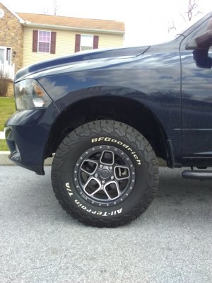

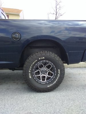

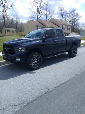

I installed the zone 1.5" body lift on my '12 Quad cab. Bils set at 2.8 and a 3/4" tgc rear spacer, love the results. I agree the alignment pins in rear bumper are a pita... A cutoff wheel and an air chisel finally did the job. I didn't weld the bed spacers but I did bolt them to the bed, no issues. Have plenty of room for the BFG KO2 all-terrains now !
