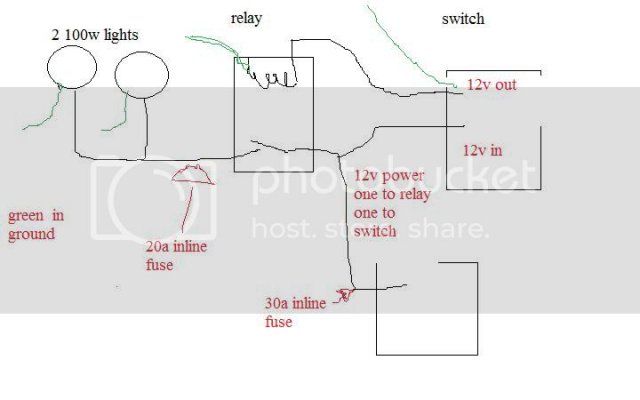

i have a set of hella 500's and i upgraded to 100w bulbs. I am using 12g wire and a 30a relay but i keep blowing fuses:flipthebird:. So i am going to do is pull out the relay and wire directly to a switch. The 2 lights will draw a max of 17amps. So can i use a 20amp switch or should i use a 30amp switch? Where can a get nice looking switches?

it keeps blowing the 30a fuse but the fuse size shouldnt cause it to blow. its only 2 100w bulbs so max amps should be 17. i have 2 inline fuses one 20 and one 30 at the battery. also can i run the ground on the fire wall.
heres a funky drawing of the layout
Sounds like you have a short happening, make sure there are no nicks in your wires, that setup should run your lights

coming off the coil on the relay i hooked it with the ground from the switch and grounded them to the fire wall is that ok.

Its not long enough to make a difference, there is something causing the circuit to pull more than 30A, by running dictated lines you reduce the interference, or make sure your grounds are connected to bare metal
Looks like you are doubled fused on the lamp side. The switch side, coil of the relay needs the 20A fuse inline with it. The 30A fuse should be right off the battery going to the relay. From he relay to the light doesn't need a fuse. Run the ground to the firewall or battery.
Looks like you are doubled fused on the lamp side. The "switch side", coil of the relay needs the 20A fuse inline with it.
The 30A fuse should be right off the battery going to the relay. From the relay to the light doesn't need another fuse. Run the ground to the firewall or battery. Your problem is the switch on the light side, it should be inline with the coil. Turning the switch on allows current to flow through the coil, causing the contacts to close for current to then flow from the battery to the lights ..

:happy107: o yeah i got it figured out. i feel like a ******* i wire the switch wrong and it was causeing it to short out. i will have pics up later of the finished product.
