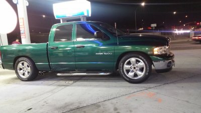

Installed my drop yesterday. It's a hybrid/piecemeal affair with coils, shackles, and shock extenders from McGaughy's, drop springs, and Bell Tech Street Performance shocks on all 4 corners. I also have the Timbren rubber springs to replace all of the bump stops, I just need to fab up the mounts for the rear and cut out the front bump stops.
Where you live? I'm in the Daytona/port orange area an drive by that spot where you took the pic where the old mobile home lot next to the Halifax. Always makes for good pics
