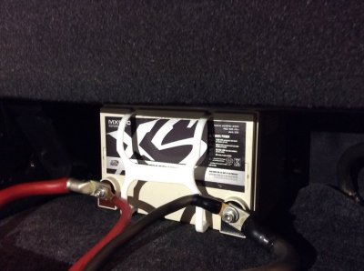

I didn't do the big three personally, just ran 0 gauge from factory battery to a secondary battery XS MX950. Going on 2 1/2 years with no issues, or dimming lights.

Where is that hidden at? And did you use a battery isolator?

Hidden under the rear driver seat. It's fused from front battery to secondary battery and then fused between the secondary to the distribution block.

Got ya. The box I have is going to take up that space. How may watts are you running tho?

Mosconi AS 200.4, Mosconi AS 100.2 & JL Audio 750/1 = 1750 watts
