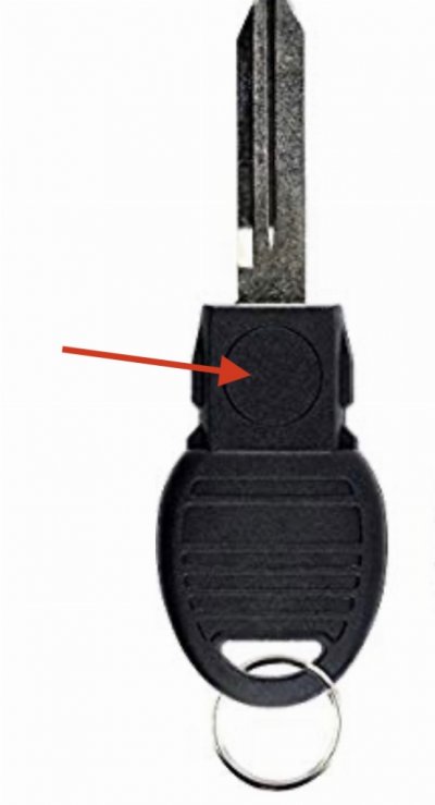

It doesn’t matter 2013 or 2018. The metal key blade only serves one purpose- to insert into the lock cylinder of the door or tailgate. The style key that you want doesn’t perform any function when inserted into the ignition. You can take a saw and cut the blade completely off, and the ignition will still work, because the rf chip inside is what allows the ignition to start the truck- 7NpSPqp.jpg
There are three styles of fobs for the ignition on the 2013-present Rams, and from a technological standpoint, they all start the truck the exact same way- they send a signal to the RF Hub, which gets verified, then the truck is allowed to start. One system isn’t any “simper” than the other, technologically speaking.
The only reason your 2018 came with the type of key fob that it did, is because it has remote keyless entry. So, you use the buttons on the key fob to remotely lock/unlock the doors. If you would have bought a 2018 that doesn’t have power door locks, or remote keyless entry, then you would have gotten the key fob with the blade sticking out of it. This is because you must use that blade to physically unlock the door every time you want to get into your locked truck, and it is more convenient than having to pull the blade out of the hidden compartment every time you need to unlock the door.

If you ordered those bladed keys from amazon, the dealer would charge about a hundred bucks to program them to your rf hub.
I kinda like those too.
My truck has remote keyless entry, with the hidden door key.
Ive always disliked how far the fob sticks out of the socket. Im always worried that ill hit it with my knee and break something.
I may order one of those, and cut the key blade off. Clean it up on the belt sander and program it with alpha obd. Then i wouldnt have a big, fragile 3 inch plastic fob sicking out of the dash.

Those keys from Amazon are "out for delivery"
Im gonna cut the blade off and try programming them when i get home this evening.
Update:
It worked!
I cut off the blade, sanded it flush and programmed it with AlphaOBD. The whole job took 2 minutes.
Programming was flawless with AlphaOBD, as usual. It starts the truck no prob.
Its way smaller than the fob key.
