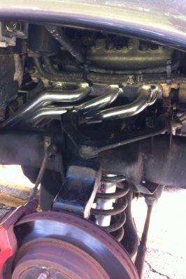

Well finally got around to getting these on. Too dark too get pics once we finished.
I REALLY need upper ball joints

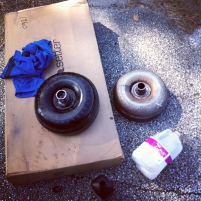

Oh yea this too :)
