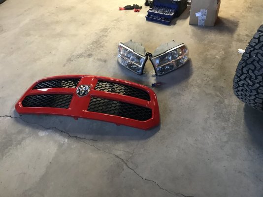

Grill and headlights off, ended up breaking the lower left tab on the grill.

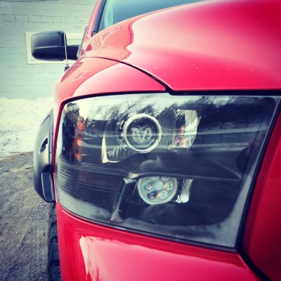

The final product, dont mind the condensation, its just because it was kind of warm when I installed it and it was about 4 degrees outside. lol.
Untitled by Black Additive, on Flickr

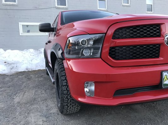

Body shot, have some spacers coming in the next few weeks to poke those wheels out a bit more. Should look pretty darn mean if you ask me.

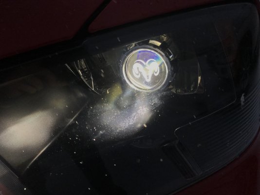

Up close of the etching.
