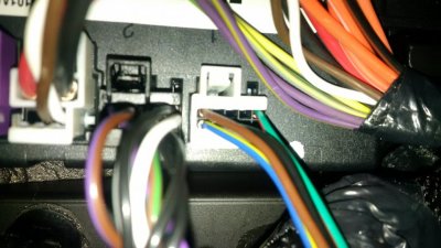

I already have the 2013 mirrors in hand and took off my driver door panel to compare and look a the module. At first glance the 2017 module does not have the 2 required pins in the black connector socket #2. I'm assuming those are for power folding as indicated by another member in this thread.
The second possible issue I noticed is the white connector #1 have different cable pinout. I may just need to remap the wires to the proper hole.
