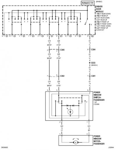

My girlfriend's truck passenger window would never work not even from driver side switch .well the other day while putting in new speakers I decided to test window for power at the plug at the window motor and found out there was none .so I decided to run a jumper wire from the battery to the purple and whatever color strip wire and now none of her windows will work .I messed up .I don't know which fuse to check or if I burnt up switches can anyone help me out with a diagram of the window wiring and which fuse or relay to check so I don't look like a ******* to my girlfriend.

It's a circuit breaker, not a fuse.... and it's likely you blew the door module, located inside the driver's door, and is part of that master switch!

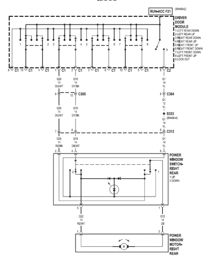

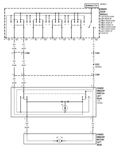

I am looking for a 2003 Dodge Ram 1500 Laramie quad cab Master Power switch window wiring diagram, all 4 windows work from the Master switch on the drivers door but do not work from the switches on the other 3 doors

Check the wiring between the door and the B pillar. It's a known break point.
