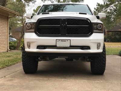

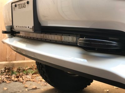

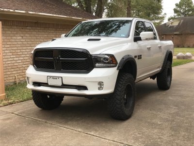

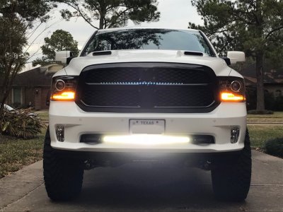

Well after a few months I finally got my 30" light bar installed. The light bar is made by rough country and is their black series curved p/n 72730BL, 150w with 12,000 lumens (Length: 31.37-inches | Depth: 3.12-inches | Height: 1.6-inches). I have the license plate bracket so I could only fit a single row, but at 12,000 lumens it lights up all I need for my use. I also wanted a single row so I could tuck it inward as much as possible. The metal/plastic bumper bracing behind the sport bumper cover prevented me from totally recessing it but I did what I could. The black series has the black face and hardware so it helps to make it "blend in" as much as possible. The light bar comes with a really nice harness and switch that made it easy to install. I designed a tow hook relocation bracket and made a provision to attach a light bar bracket to it. Its a tight fit to get the light bar with the tow hooks and still allow full use of the tow hooks but it worked.
