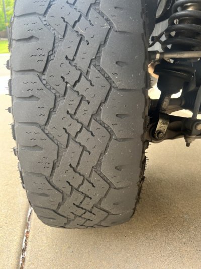

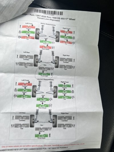

Hello! I lifted (rough country 6 inches)my truck two years ago and get my alignment done from firestone every six months. still the front two tires are wearing from inside compared to the rear tires. The alignment guy told me the camber is maxed out and it will still have some issues that he cannot fix it. Are you guys also having the same problem with RC lift? I’m attaching my alignment report before and after. how can I fix this issue? I did the lifting by myself and can’t seem to find what’s wrong did I do please help.
Thanks

The change in toe up front should certainly help.
Why the rear toe changed is beyond me, as its not adjustable.

That is a toe and go alignment nothing is really changed. Find another shop

Take a picture of your cam bolts (holding your lower control arms on)
