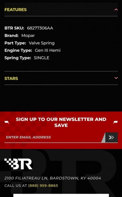

Were those by chance the 68277306AA or P5249464 spring? If so, those were designed for the eagle head (taller valve).
