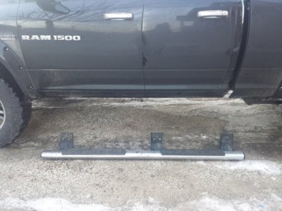

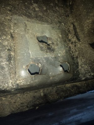

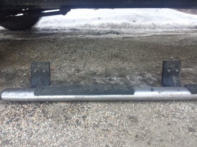

so this happened today... i guess being 250pds isn't the prescribed weight limit for daily use on these oem steps. :banghead:
I've seen some other options. And I've noticed the 2013+ OEM steps either mount at either end of the body or have 2 separate steps for front and rear.
I'm sure I can either have a reinforcing plate welded over the hangers and holes and remount these but what other options does anyone suggest? Because I only want to fix this once if possible.
I ran without steps for a while but the 6" lift on 37s tends to make getting in and out a chore. Plus if I remove them from the passenger side I have to extend chivalry to EVERYONE and who has time for that :roflsquared:

Take a plate prob 3/16" thick cut into squares the same size as the clean area. Then drill holes in pattern of bolts on steps for bolts, insert bolts through the plate so they poke out and towards the driveshaft and weld heads to the plate. Remove/cut/ drill existing bolts in step brackets, drill holes so step bracket slips over bolts. Attach with thick washers, lock washers and nuts. That's one way.
Another is to do same thing but weld nuts onto 3/16 plate and use new bolts to attach steps. Or if the metal is thick enough, drill and tap for studs and attach that way. Would be a hell of a lot stronger than the OEM thin steel.
Wow my $115 aftermarket steps attach better than those.

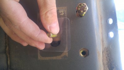

You put it in behind the sheet metal. Top bolts sticks out for a but and your bottom holes line up with the bottom holes that your nutserts ripped out of... Now the only way It's comming off is to rip the whole chunk of metal off.

Here's another picture of the bracket behind the metal.... It would be much better set up than the factory......
But I will say it would be nice if they all would mount to the frame, but if you do body lifts them you steps will stay in the same spot... With the body mount the steps are were they belong no matter what lifts you do.

known issue. If your boards are recently installe,d pick up teh amp research backing plate, then reinstall boards suung it. helps to spread otu teh weight acvorss more metal
oops, just say above postings. Pretty much same thing as AMp Research brackets.
works better than welding a plate acct welding weakens teh metal and surface area, across which the weight is spread, is not as much vs goign with backing brackets.

Where does that bolt that sticks out go? thru the top where the step hangs?
