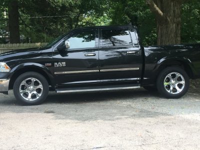

I did mine Monday, and Tuesday :) it hasn't left the garage since
