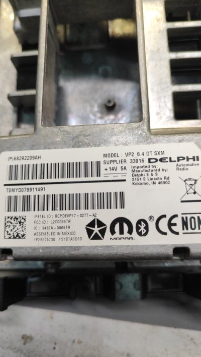

I have a file extracted from emmc by the programmer. I can attach it if neededCan you post a picture of your radio?

guys, please share, at least an updateI have a file extracted from emmc by the programmer. I can attach it if needed
Sorry, your post disappeared and moved to another location for me. I'm not familiar with that version of the 8.4 and I do not have any firmware for it. If I understand correctly, the radio won't boot at all and you are wanting to connect directly to the hardware with a serial connection to flash a firmware to it and make it work again. That is something I haven't seen discussed on this forum.guys, please share, at least an update
All of my knowledge is comes from these forums. Unfortunately I've never come across firmware for that specific radio. What I have seen is that those radios don't work well in 4th Gen Rams. Is yours a 4th Gen (Classic) or 5th Gen truck? Have you tried to power it up on the bench instead of plugged into the truck?you understand me correctly.

I want to try to unpack the update and cut a piece out of it for emmc
I have RAM 5 generation. Yes, I tried to connect it on the table. The current consumption is 500-650ma. The screen is dark and every 2 minutes, the consumption drops to 0 and everything repeats again.All of my knowledge is comes from these forums. Unfortunately I've never come across firmware for that specific radio. What I have seen is that those radios don't work well in 4th Gen Rams. Is yours a 4th Gen (Classic) or 5th Gen truck? Have you tried to power it up on the bench instead of plugged into the truck?
