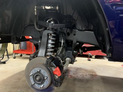

I'm thinking about which lift kit to get for my 4WD truck and I cant seem to find any bigger than 6". I found a Zone 6" (Sister company to BDS) that you can get with a 5" coil in the back to retain factory rake. I was thinking I could pair that with Bilstein 5100 or 6112 in the front set at around 2" to get 8" of lift. Would this end up having terrible angles? Also does anyone have experience with zone off-road or know of others with zone kits?
