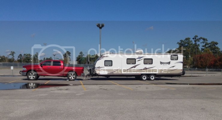

ok... here are the pics loaded. Again what I have here is a 2" Bilstein front level, air bags with 0 air in them. Had .5" of sag from front to rear. 1 pic seems to look like more but the tape measure doesn't lie... I hope. I just rode down the road to a big parking lot to take these. Ride was good, better than stock springs with 30 psi in bags I beleive.

looks like about 2" of sag between loaded and unloaded. I had 5 links hanging on wd hitch. I could tell a difference when I hooked the wd hitch up in the sag. It really help.
