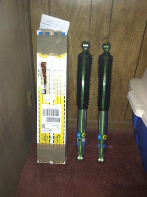

well these came in on Saturday. I emailed about the tracking number for the springs and haven't gotten a response yet. Gonna give it til Monday then I'm calling.

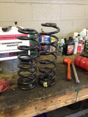

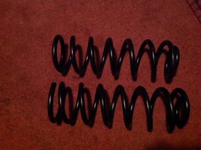

Got them today. 17.25" in length. Not sure what that compares to stock.

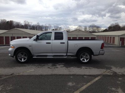

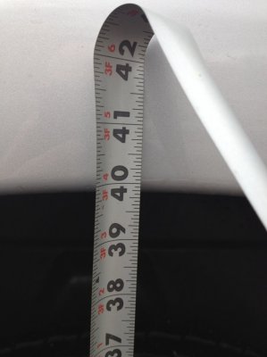

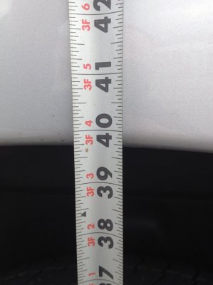

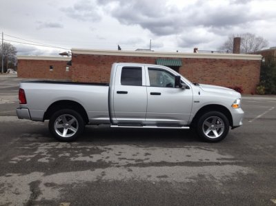

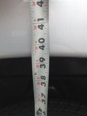

cableguy_hd
cableguy_hd
May 2, 2013
1,566
437
Danville, Va.
2020 Ram 2500 CTD
6.7 Cummings

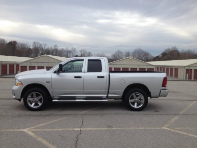

here are before pics. I hope to get these on on Monday. Gonna do the springs only and take measurements before I add shocks. I have 3/4 tank of fuel on no air in my air bags.
Front measures at 38" and 38.25" just for reference...
I'm not sure what the stock coil spring length is, but I do know my TufTruck 1223-V springs are much thicker and heavier than OEM. Can't wait to see the new springs installed. Wish they would have been around last summer before I had mine installed.

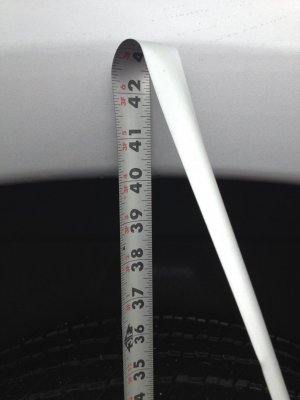

cableguy_hd
cableguy_hd
May 2, 2013
1,566
437
Danville, Va.
2020 Ram 2500 CTD
6.7 Cummings

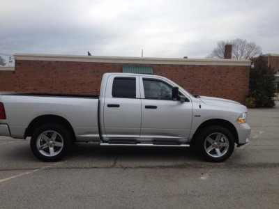

got new springs in today. Didn't do shock install. I was limited on time. Not sure if the will settle but these measurements are right after install. looks like an increase of 1/2" in height right now. 1/2 tank of fuel ( 32 gal. tank ) no air in air bags. tried to park in same location. The ride is stiffer. I tried to hit man hole covers and joints in the rode but overall not too bad. I will be doing some back road driving in a few to get my daughter from school so I'll report how it does. Highway driving I think it would be fine. It was pretty smooth when I wasn't trying to hit anything. BUT those that want to get these springs should know its gonna be a stiffer ride. Unless you're real picky or have a very sensitive ass cheeks its not bad. Anyway I cant load it up till Sunday. Golf cart is broken and been raining so I aint going in the back yard to get the camper yet.
