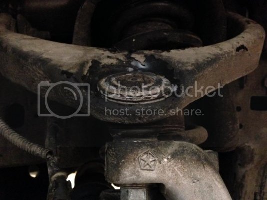

For those that are considering a spacer level kit as an option to level the rake in their Ram, beware, Chrysler is not covering my ball joints because of aftermarket modification.
i was provided this STAR case from Dodge today when my 7 week old , 3000 km truck popped both upper ball joints while installing my ProComp Nitro Lift level kit PN 61180K. I'm not sure if it is specific to 2014 Sport Crew Cab models or not, but the STAR case is dated 05/23/2013.
here are the pics of my upper ball joints right after re-installation of the lower control arm. this happened to both upper joints on both sides.
Chrysler refuses to fix the UC arm and ball joints because of the addition of aftermarket components and the estimate is $1100.00 to repair.

Im sure you can get a set Upper control arms with new ball joints and bushings from Rock Auto (pretty sure UCAs are same 2009-2014??) and install them yourself for 240 bucks. Then pay 150 at Firestone for lifetime alignment. Nature of the beast, leveling kits put stress on BJs, TREs, and CV shafts. Gotta pay play bro. But don't pay 1100. Screw that.
Next time remove the aftermarket part that may have caused the damage.

yeah, good point about removing the spacer, but the damage was already done. even if i took the kit out, i still had to tack weld the ball joints in to the control arm. they would not stay pressed. looked like they rounded the seat on the control arm. the dealer wants way too much money...but ill have to see what options i can come up with.
the biggest point of the thread was to inform about the tech bulletin regarding spacer kits.

thanks for the tip....im researching some options now until i can figure out what to do. i plan on escalating with Chrylser. even though these kits do add some added stress, there is no way the kit should do this to the control arms.
im not convinced that something didn't change from the 13-14 design...but I'm speculating.

They wouldn't. They would do the same thing. The spacer itself has nothing to do with it. It's the change in geometry and the limited ability of the ball joint to compensate the angle change of being 2" taller

im a little confused here....the ball joint popped out while the leveling kit was being installed? who was installing the kit?

I don't understand.For the top ball joint to pop it would have to have upward pressure to pop it out and putting lifts and block on it will pull it down pulling it farther in the hole not push it up and out of the hole.
yes they popped pout during installation. when the lower control arm was being put back in.
not sure the science behind it, but the spacer mounts on top of the strut assembly. the pressure comes from below when jacking the lower control arm back in. that is when the ball joint came un seated and rounded the hole so it would not go back in.

It's simple geometry. It doesn't matter how the lift is achieved, only the fact that your upper ball joints are now 2" further away from the lower ball joint. This causes the upper arm to be angled down further, the increase in angle cannot be compensated for by the upper ball joint's range of deflection. The picture clearly shows the upper ball joint unseating from the arm on one side only which decreases the working angle of the ball joint. Installing 5100s would simply be a waste of money
