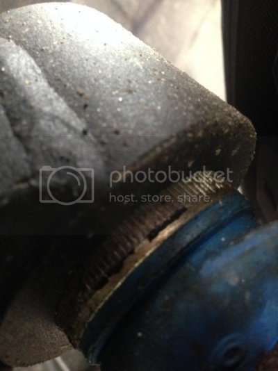

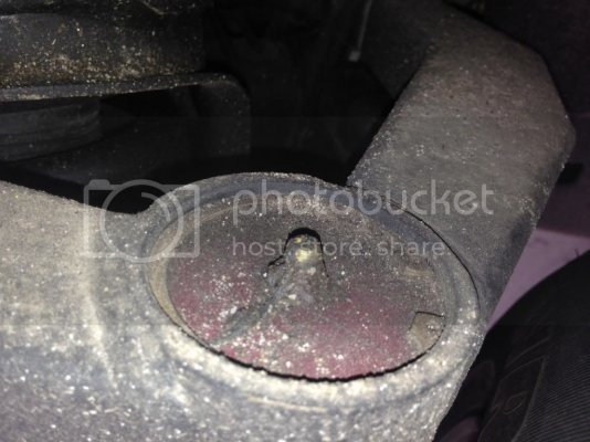

so i never really looked all that closely when the zone UCAs were installed two weeks ago, but i thought id take a look underneath the truck today to see how everything is holding up. am i loosing my mind, or are these ball joints now coming unseated from the bottom?
:doh:
im guessing they are not because the top seems to be in place, but it does look weird...and of course i beleive i feel a little rattle and clunk when turning the wheels in the front...

That ball joint looks fine to me. It comes out from the top, not the bottom.
I doubt the Zone ball joint could come out, given the design. If they failed, they would just snap off at the shank. Just hope you aren't at speed if it happens!

Have not installed mine yet and the ball joint sticks out like that on my brand new ones. Your good!
