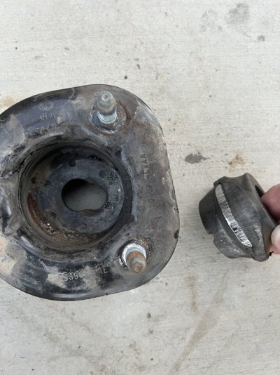

Before installing my leveling spacers, I knew that the ride would not be as good as a full leveling strut, but I never saw anybody talking about the long term wear effects of of the altered suspension geometry, aside from ball joint wear.
For the past 60k miles on my 2015 EcoDiesel, I had been running a spacer kit, with readylift upper control arms to address ball joint wear. Really had no complaints with this setup, aside from the noticeably stiffer ride.
I did start to develop a front end vibration/shimmy in the last 10,000 miles or so, but chocked it up to cupped tires due to needing an alignment. But on a 5,000 mile road trip, it became very apparent that something was wrong. Took it to the dealership while 1,800 miles away from home and they said the alignment was out, but everything else appeared to be in good order. The alignment seemed to fix the issue for about 800 miles and then the vibration got worse and worse.
As soon as I was home, I went ahead and pulled the whole front suspension apart to inspect all the components and I found the top strut mount bushing to be in really bad shape from the modified suspension geometry putting stress on the strut mounts (see images).
Got everything replaced with a Bilstein 5100 leveling strut system, tires replaced and aligned. Rides better than it ever has!
Long story short; I am sure spring spacers are fine for the live axles trucks, and for other applications, but the strut geometry is pushed well beyond its design with the longer strut that occurs with a strut spacer on these 1500 trucks. I do not recommend anybody use strut spacers to level/lift these trucks as the spacers will cause damage to your suspension, that if left unchecked can cause a tragic accident!
Hope this info helps!

ZackMac26
Sep 5, 2022
USA
3.0 EcoDiesel
Actually is is not the spacer against the bushing that caused any of this wear. The spacer causes the shock to move at an incorrect angle every time the suspension cycles. All of this wear was caused by the strut itself.
I agree that inspections should be done, and they were. Ball joints, end links, control arms, etc. These inspections showed no issues with abnormal wear.
You cannot inspect for this type of wear unless you completely remove the strut from the vehicle.
The point of this post, was not to say that those of you who are running spacers are wrong, it’s more to warn those looking to purchase a kit of the potential issues running this type of setup.
