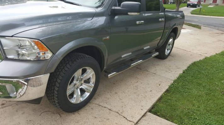

I have 275 65 20 duratracs with a HBS levelImageUploadedByTapatalk1443885003.155567.jpg
No rubbing, no issues and wearing great. Put them on in December or January.
