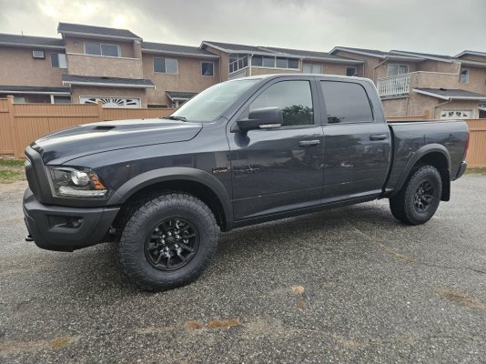

I can't seem to find a clear and definite answer on this because everybody is running aftermarket rims but if I get a set of 285/75r17s on my stock warlock rims with no spacers or lift, 100% factory, will I get any rubbing. The truck is new enough still I don't want to modify anything and I'll go 285/70r17 if its going to rub.

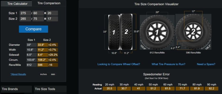

Seems like it should be fine. Looks to be only 0.5" wider and less than an inch taller than what came stock on my 2019 Warlock which is 275/60R20.

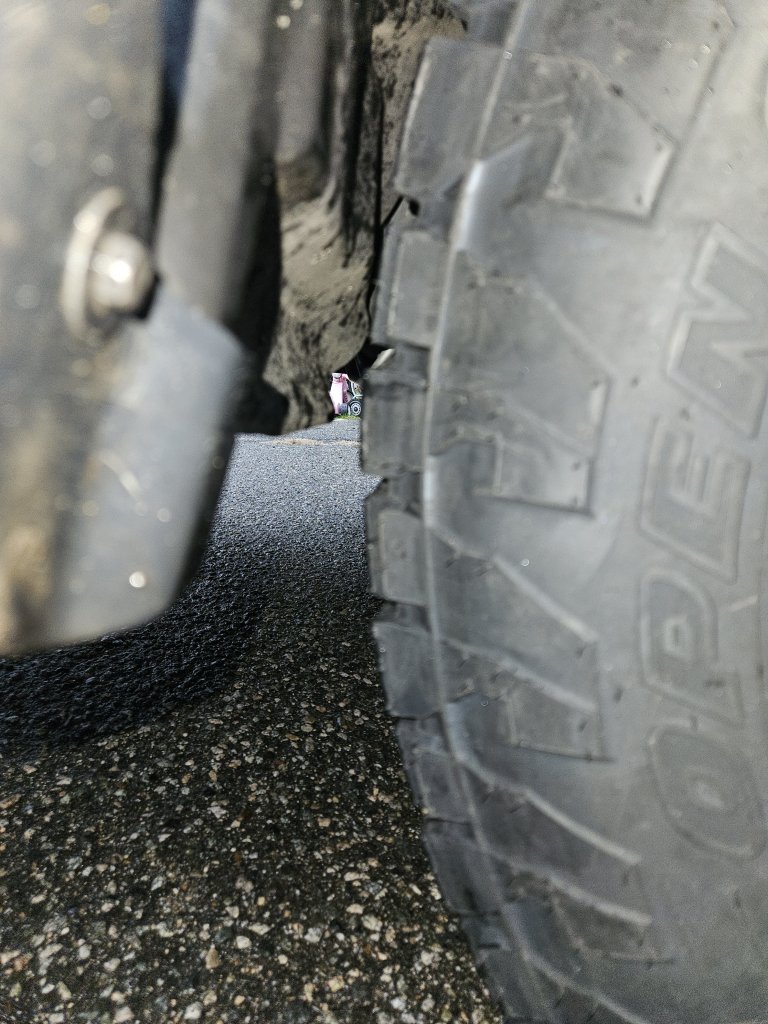

Not sure in your exact case, but my 2011 has 285/75/17's on stock rims, but I run 5100 shocks at 2.1" . No rubbing but the tire sidewall is close to the upper a arm, like an index finger width, but it has never touched and I drive fast and off road with it a bit.

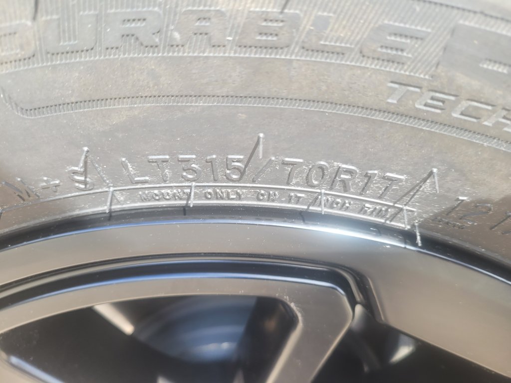

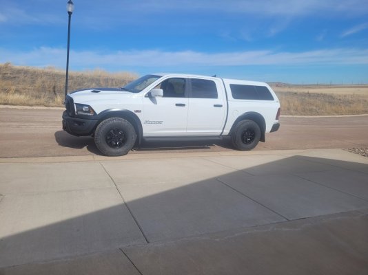

My 24 warlock, classic I'm running 315 70 17 s with no rub.on stock warlock rims
