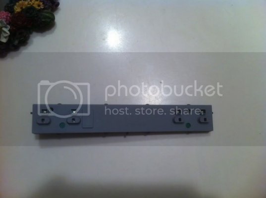

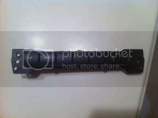

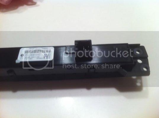

I believe I may have bitten off more than my knowledge on electrical wiring and circuit boards so I'm looking for some help. This may or not be able to be done, but I'd like to take a crack at it if someone could give me a little guidance.
Here's what I'm trying to do: wiring up a factory aux switch from the 4500/5500 Chassis trucks into the lower slot of my truck (where the factory heated seats would be). Right now, all I have is a blank panel there. I know this will fit perfectly in the slot.
So this is what I've got:
Here's the backside of it:
When you take off the backside:
When you take the rubbery piece off:
What the backside looks like:

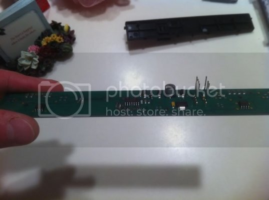

So my question is, is it possible to wire this for my off road lights? Right now I just have them wired to a simple switch. I'd also like to run my cutout into one of these ports too, if that's at all possible. Or are there more components that I would need, such as whatever plug would normally plug into this switch panel (pic #2)?

So is the pinout what it would plug into in pic 2?
I don't care about wires, there's tons of room behind the panel to hide my wiring. So if I need a bunch of relays and crap that wouldn't bother me.

get some info and see what we can do. I bet there's connections for illumination, power to switches(single power feed in) and power out for each switch. I bet they are controlled by the BCM because they are only momentary switch. So that means you'll need a latching circuit to keep them "on". In these newer vehicles everything is controlled by the computer.

It does not come with a schematic and I was unable to find one. I took the switch apart to figure out Hot and ground and output pins. There are no lights that come on with dash lights. When you hit the switch it will light up amber and kills power to output pin. All outputs have voltage until switch is pressed. The output is not a ground. When this setup comes from the factory it is run through an Aux power box.
Here goes, hold the switch so that the lock indent is at the top, missing pin location is bottom middle right (pin6). Pins reading left-right, top-bottom are:
4321
8765 pin 6 is missing on the switch
or clockwise from missing pin 78 4321 5
1 +
2 -
3 Switch Output #2
4 Switch output #1
5 +
6 No pin
7 Switch output #4
8 Switch output #3
Pin 1 I believe is power to switches 1&2
Pin 5 I believe is power to switches 3&4
Be careful verifying this as one pin supplies the power for all the LEDs on the switches but not the actual switch?? (this is what I observed but my mind was fried by that point.)
This is what allows you to have one set of switches constant hot and one set ignition hot. If you want to have both ignition or both constant you just connect them both to the same source of 12 volt. They are to be fused at I believe 5 amps either way. A good source for this power is the 12 volt plugs in the dash one is constant, one is ignition hot. You can not use either of these as your power source for the relays though as they are not rated for the that much amperage.
