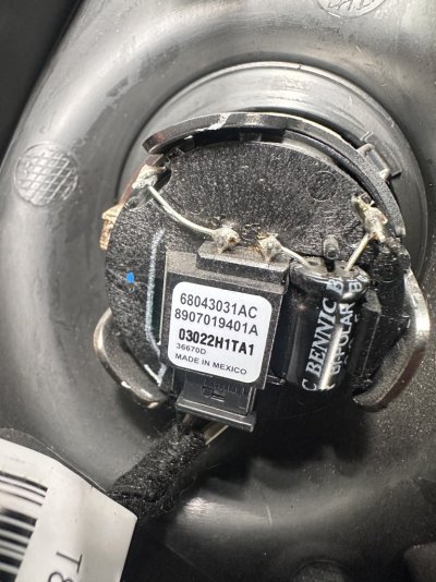

So i got some door panel tweeters OEM from a 2023 limited longhorn Ram i have 2017 Ram Rt, i wanted to ask if anyone has done the wiring for this or could tell me what to tap in to
The connector pics is the factory harness from the 2023 limited longhorn Ram that plugged into the tweeters

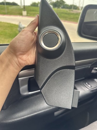

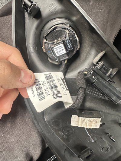

yes i do, i just want to know where can i tap this tweater into, some people said door speakers but wouldnt it be too much for that tweeter?

So the front doors and dash speakers are wired together utilizing the same channel. Personally, I think maybe you should look into getting a Kicker Key 200.4 amp and bi-amping the front stage, then put those tweeters on the unused door speaker wires.
