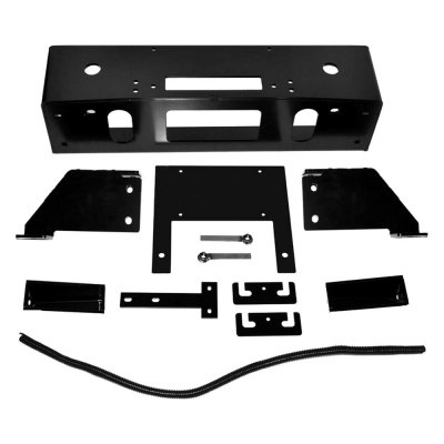

Haha. Yeah, that would work. The metal bumpers on the 13+ are solid in the center so it would require some cutting. This is what I would like for my truck. I think this would be a very clean install.
