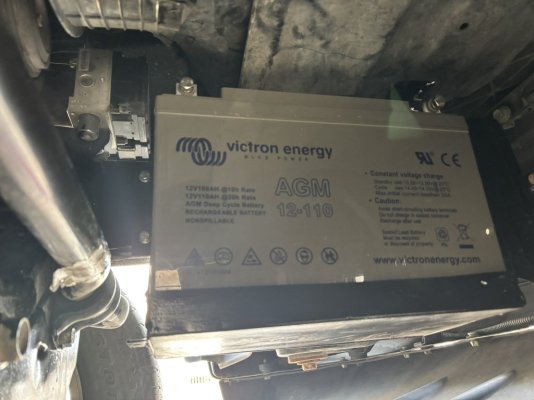

Good day,
I would like to share my idea for a dual battery system. I have walded steel socket which is mounted directly on inner side of frame. My battery is too big to fit in underhood so i fit it under engine, it is close to star battery additionally it is nice for center of gravity. I am afraid how I fit winch in the futer but currently i am not planning this mod. Second think what i am afraid it is dirt on connectro of battery, by i belive that skid plate will solve this problem.
Additionally, I am planning to share with you any modifications I plan to make.
If mounting a battery under the vehicle, put it in a battery box made to keep the mud, and water off the battery. Lots of AGM batteries can be mounted horizontally.
4xdad
Feb 18, 2021
2,316
2,521
Edmonton Alberta
2015 powerwagon
and make sure to isolate the + terminal x2 if unthinkable happens you will want the battery isolated. a rollover could smash the battery box
