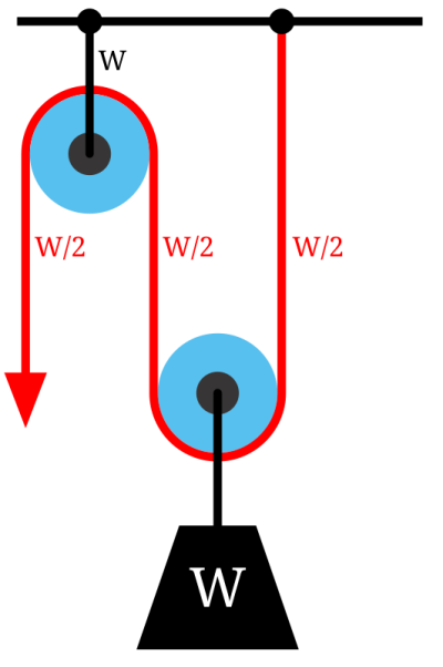

You're going to mount it and unmount it as needed, it sounds like, so weight matters. Remember you aren't trying to lift the truck vertically and you can always rig pullies to multiple the force. If you're willing to take the time to rig better, you can get by with less powerful equipment.
I learned this for heavy recovery, like pulling a tank off something that high centered it, but the same applies to using any "underpowered" winch to make it more effective.
Just a simple example that would require two snatch blocks and sufficient line: Imagine the black line is your bumper. A snatch block is attached to the recovery point represented by the black dot on the left and your winch is the black dot on the right. The snatch block with the "W" attached is hooked to whatever anchor you are using (tree, etc) and then the red arrow head would ideally be hooked to a different tree nearby to spread out the force, but if it's a big sturdy boi and you trust it, it could be the same anchor point.
This is *usually* overkill for truck winches but you can rig several pullies together and even a hand winch will move your truck. You are trading required pulling force for time, basically, so you can move more weight but it'll move slower as a given length of line pulled in will move the vehicle a shorter distance with each added wheel in the pulley system.
*SO* this doesn't answer your question, but gives you another decision point to consider before making your choice if you want/need a heavy winch (or a powered winch at all vs a hand winch).
Thanks, I had not given snatch blocks much thought (though I mentioned it to the wife when we discussed this this morning)
They are in essence simple tackle blocks as have been used for ages to multiply force in farm and seafaring

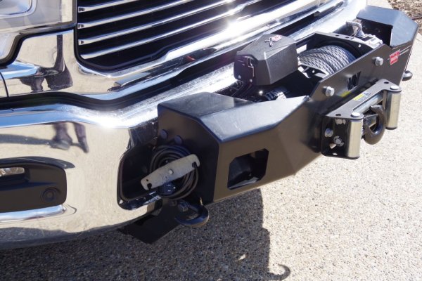

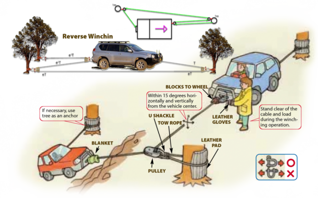

My 2500 now has a Warn 16,500 lb winch with synthetic rope. My previous had a 10,000, and any amount of stuck needed 1 or 2 snatch blocks due to weight and drag. I carry 300 feet of extension cable and 5 snatch blocks plus tree straps and shackles.
This was the first winch, a Champion 16,000 with steel cable. It was inexpensive but I did not like the way it worked, slow line speed, wouldn't free spool properly etc. I went back to Warn, even though it was almost 3 times the price. I have always had Warns on my vehicles and never had issues. One of them I still have, is a 40 year old 8274 that is on a 1500 and the 30 year old 10,000 lb on my other 2500.
If you have a plow on the front, permanently mount the winch on the back. With three snatch blocks and a couple of tree straps, you can easily pull the PU forward if you want to.
This is a front mounted winch, for rear mount just reverse the rigging.
Everybody thinks a receiver mounted winch is a great idea because you can use it front or back, doesn't work. Any hard side pull you will quickly see why. Receivers are meant to withstand straight forward and back force, side force not a good thing.

Regardless somebody should be familiar with the proper rigging and setup of a winch. Different angles and setups can make a big difference in how effective a winch is and how it pulls. For example only pulling out 10' of cable and running it at a sharp angle really reduces the pulling the power.
