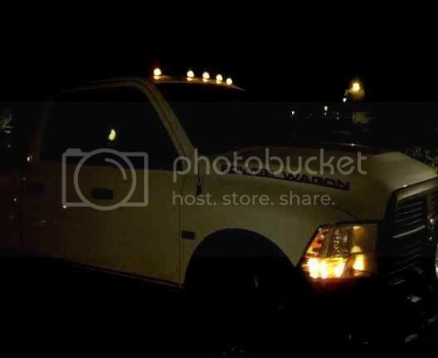

Here’s a simple write-up on turning the tow mirror turn signal lights into parking lights and signal lights using diodes and resistors. This allows the lights to function as normal signal lights with the parking lights on at a dimmer level. The resistor can be changed to adjust the brightness of the parking lights. I am doing this from memory, so please test each wire before cutting or tapping in to it. Also, test the direction of the diodes before soldering. I’m fairly certain I stated the correct direction, but you’ll need to make sure. Installing them backwards won’t damage anything, they lights just won’t light up. You’ll need two diodes for each door (1N4003 or similar from Radio Shack will work) and one resistor (standard ½ watt will work). 100 ohm is what I am using for now.

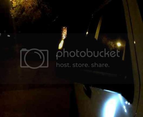

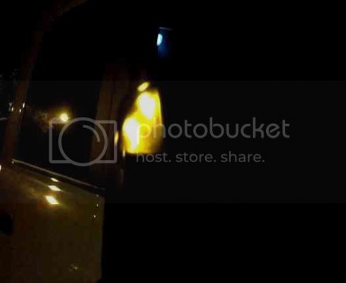

Since my truck has factory cab lights, I was able to tap into this wire behind the passenger side A-pillar cover that feeds them. I’m not sure if all trucks have this harness or not. If not, you’ll need to find a wire that’s on with the parking lights. To remove the A-pillar cover, pop open the covers and remove the two 10mm bolts. The cover will then pop off. The wire for the cab lights is white with green stripe. Splice into this wire and run it down to the passenger kick panel. Connect the two wires from the doors to one side of the resistor and connect the wire from the parking lights to the other side. I used male and female spade connectors to wire up my resistor. This allows me to easily swap out resistors if needed. I first tried a 50 ohm resistor and there wasn’t a lot of difference in output from the turn signals to the parking lights, so I stepped up to a 100 ohm. This is plenty bright at night and there’s a noticeable difference in output when the turn signal is on. My lights are also tinted, so your results may differ. Reinstall the kick panel covers and door panels and you are done.

Great writeup! I'm assuming the lights are flashing fast because you're just hitting the unlock versus the regular turn signal being a slower flash?
Yes, I was just hitting the unlock button. I don't know why I didn't turn the flashers on, that would have made more sense. Drank a lot of *** last night, that could be part of it. :D
