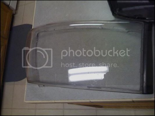

This is a top view to give you an idea of what your trying to do.

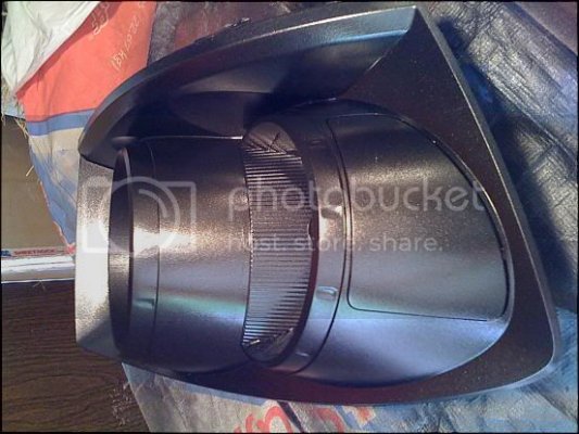

Where the clear housing meets up with the black piece is where you need to slide in the screw-driver to separate the housing. Note the tabs, try not to break these since you'll want to use these again later, they pry up pretty easy though so that shouldn't be a problem.

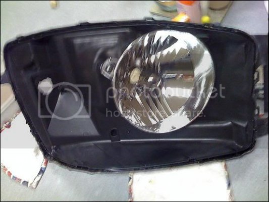

Take your time, do a good job without doing to much damage and make your way around the headlight separating/prying apart the headlight. If it becomes too tough to separate, then put it back in the oven after it's cool to the touch for another 10 minutes and repeat as necessary(The first set I did was on my truck and I did have to re-heat them once, but the next 2 trucks I've done since then I've gotten apart in 1 shot( it's no big deal just make sure they are at least cool to the touch before re-heating ). Once you separate the clear housing from the black backing, the chrome piece with the reflector just pops out(take note of how it pops out since you're going to have to reverse this process without scratching your fresh paint job later)and it should look something like this.
**If you have other plans for the reflector on the side of your blinker besides painting over it, now would probably be a good time to take it out (4 little clips will do it)**

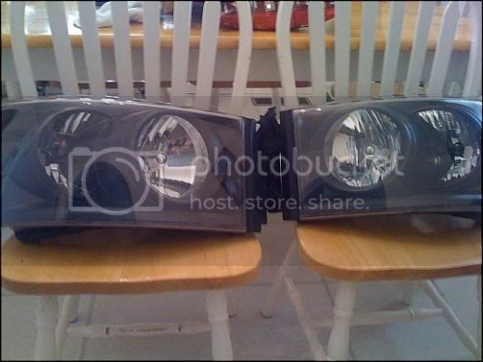

Anyway, however you decide to paint, when you're done it should look like this
The directions on the paint can said to wait an hour before handling, I usually wait atleast 2 or 3 just to be on the safe side. I would definitely wait an hour though. Now it's time to start putting this thing back together and wrap this job up. Go back inside your house (you did paint outside or in a shed or something right?) and very carefully slide your freshly painted pieces back inside the clear housing. I cannot stress enough to take your time and if it's not going in, carefully slide it out and try again, if not you will be looking at some scuffed paint.

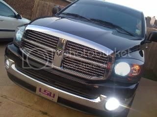

I added another bead of black silicone around the edges when I was done to get it as close as I could to a factory like seal. If you skip this step then you can put your headlights back on your truck now, if you do add another bead of silicone wait until it dries because it gets a little messy. I only added the last bead of silicone to the last truck I did so I'm not sure how much it helps in preventing the light from fogging up like I find mine from time to time first thing in the morning, it's nothing that can't be cured by turning your headlights on for a few minutes though so this last step is optional. That's about it....here is what I ended up with.
