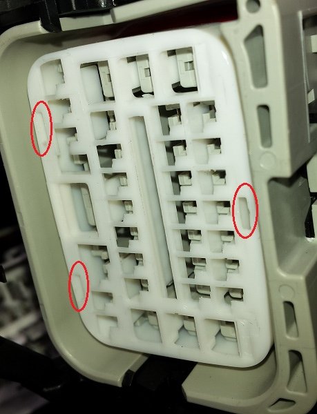

Front end side of the connector. Carefully pry up on the lock ring at the circled  tabs and remove.
Moab_Rockstar
