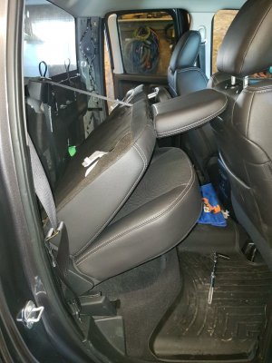

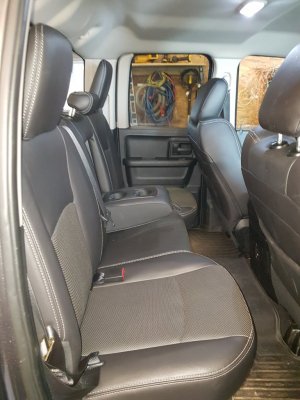

Looks factory. I was wondering how tight it would be. Do you have your front seats pretty far forward in those pics?
marcki8506
Dec 4, 2017
64
18
Montreal
The front seat is very to back. I mesured 5feet11 and its ok

Wow, that fits better than I thought it would.....so after all this time I was ignoring crew cab seats, they might actually not fit badly?
Were you able to get measurements of leg room before and after the install? I just worry Ill lose a lot of legroom because of the "deeper" seat bottom.

I did this also,used quad brackets.I took it out after 6 months,problem is the back of the seat is too straight.Very uncomfortable to sit back there.Headrests have to go also if you want someone to sit there as they tilt towards front of truck.My advice is don't do it.I put a leather split seat in from a 2012 laramie quad.perfect
