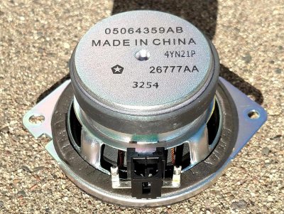

2. The Alpine system speakers are not actually Alpine, only the amp/processor was designed by them as far as I know.
I agree. Here's a pic of the backside of the dash speaker that came with the Alpine system.

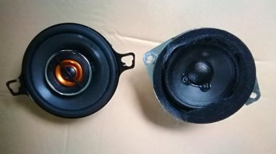

Whole reason the aftermarket speakers sound better is stock alpine has no tweeter, just full range cheap cone. Here is a stock alpine 3.5 vs jbl gx302.

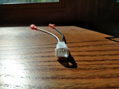

I'm considering upgrading my speakers - what is the number for the wiring adapter for these?
My Polk dash speakers DB351--Metra 71-039C wiring adapter. The push on spade connectors on the end of the wiring adapter that connect to the speakers are two differing widths. The white wire on the adapter is positive (+) and is wider than the black wire negative (-). I presume that is the standard for all aftermarket Mopar type dash speakers, but I don't know for sure.
Here's a pic I took three years ago. Sorry I don't have a clear shot of the terminals on the end of the wiring harness but you can see the white terminal is wider than the black terminal. If you go with this wiring adapter any replacement speakers you use should have terminals of different widths.
Also, what's involved in doing this upgrade? I've seen videos on older (2015) Rams - is it the same as them - just pry off the screen, unscrew and replace?
Yep, pry off the plastic grille, tilt the front edge upwards and lift out. Ridiculously easy. You will want to use something non-metal to pry the edge of the grille loose. I had some plastic interior trim removal tools which were made for the job. I suppose you could wrap the end of a flat-bladed screwdriver with masking tape and carefully remove the grille without scratching it. Or maybe the long edge of a credit card under the lip of the speaker grille and then pry it up. (Hopefully the credit card won't snap in half!)
The hardest part of the job is getting the little hex head screws out of the dash. I ended up using a very small socket wrench and stood outside the truck with the door open, reaching my arm in from the outside.
