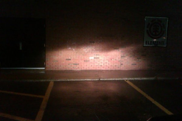

Hey man its not your fault. You did help me a lot its just that I still dont have any brights lol And my low beams, the one in the picture, kind of go in different directions. My left headlight seems like it goes off into on coming traffic too much and my right headlight is pointed too much down. I lie the look of them but I dont like not having brights if I need them. And I dont want to get a ticket because the cops around where I live will write my ass a ticket without hesitation if they feel like being a ********.

but are they aimed properly. even after time when springs sag the lights need to be re aimed or else they will be aimed too low and give you crappy light output. also after you replace light housings you need to re aim your lights or you could end up with poor lighting. i know i learned this after i bought some aftermarket light housings. they were not too bad after i aimed them properly but pretty crappy before i aimed them. on the older vehicle the line on the wall is suppose to be about 2 inches lower on the wall than it is on the light housing at 25 feet away. i don't know about the 2nd gens but i would guess it is similar.
