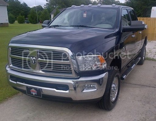

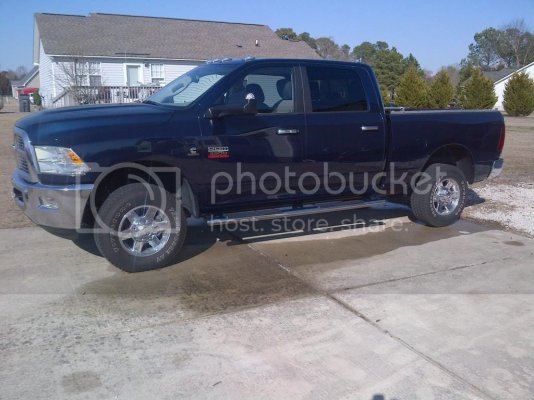

Pics from when I first brought her home

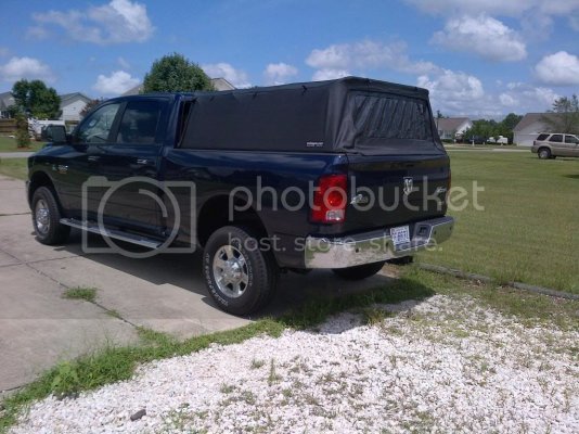

All geared up for our first camping trip with the new Ram. :D

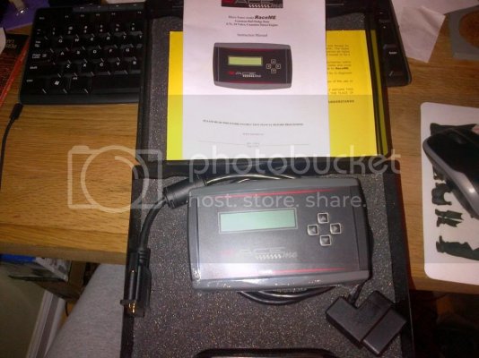

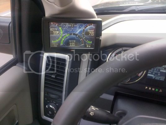

Mod #2 - Removed DPF, installed SIMS, Edge Insight CTS and straight pipe exhaust @ 5500 miles.
Added RaceME tuner about 2 weeks later.

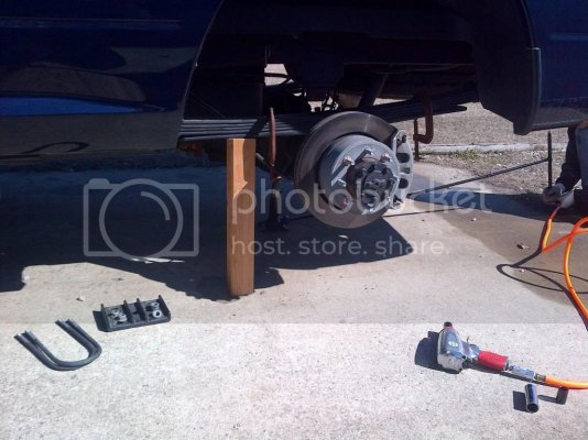

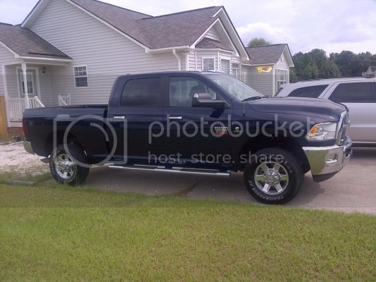

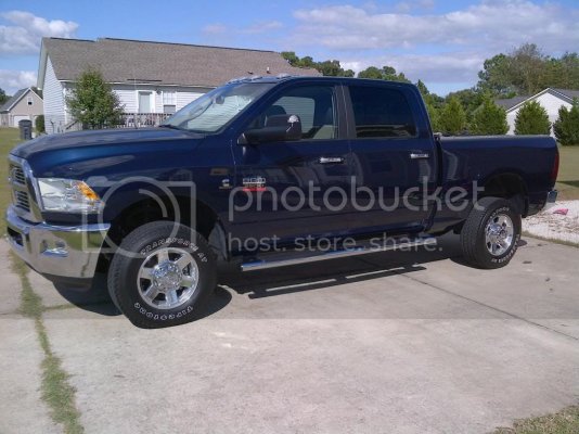

Mod #3 - Lowered the rear of the truck ~1 inch using the 'reverse level' method.
Basically unbolt the axle from the spring pack and move the desired # of spacers from between the axle and leaf pack to the top of the spring pack and reinstall factory hardware.
Before heights:
Front wheel well - 39 3/4
Rear wheel well - 42 1/4
Bumper - 27 1/2"
After heights:
Rear wheel well - 41 1/4
Bumper - 26 1/4"
Statcher1
Nov 2, 2013
4,419
2,477
Kentucky
Looks good man. But something about that soft topper. Makes it look like your frame is bent in the middle. To me at least. Lol

Thanks man!
And yeah... It kinda does from that angle. LOL!!

That was the first thing that popped in my head when I seen the pic from the back. How does that top do on the road?
Power247
Power247
Jul 26, 2012
5,615
947
High Point, NC
6.4 HEMI
Very well actually. It's water tight and barely moves at all, even at highway speeds.

@ WhiteExpress. It is a pretty straight forward job. Total time was about 2 hours which included several trips from the driveway to my workshop in the back yard for tools and cleanup. Once we finished the drivers side the passenger side only took about 15 minutes. You definitely want a second set of hands too. I normally do my mods alone but I was happy to have help on hand for this one.
If you remove the overload you need to leave a spacer or 2 or add airbags. Otherwise you will be riding nose high.

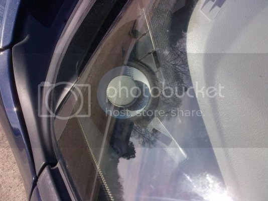

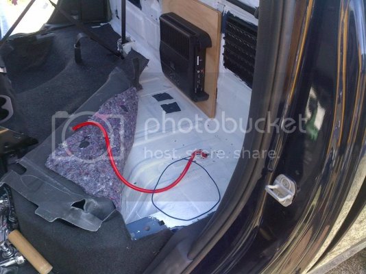

Started the audio upgrades last weekend. Full write up is Power's Budget Audio Build
Started with soundproofing the rear of the truck and mounting the amp.
Yesterday I replaced the dash speakers with some Infinity Reference 2 ways.
Hopefully will be able to start on the sub boxes next weekend if the weather holds out...
