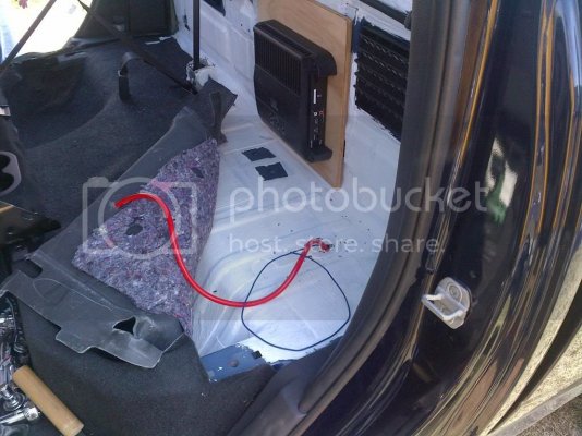

Installing the amp
While i had everything apart i decided to go ahead and mount and wire the amp. Sadly it will be several weeks before I can get the fiberglass boxes built for the subs :(
I used silicone to attach a piece of plywood to the back wall (remember the 2 strips of blue tape from before :) ) This gives a sturdy place to mount the amp without drilling holes in the back wall of the cab. Many thanks to UNBROKEN for the tip.
I drilled a hole in one of the plastic knock out plugs for the 4 ga power wire and amp remote wire. Both are run along the frame rail under the truck beside the brake lines and up into the engine compartment.
I reinstalled the carpet and cab liner, cutting the liner around the amp. At some point i will paint that board black to match the liner but really, no one will ever see it.
For signal to the amp I used all 4 wires that were connected to the factory sub. The JBL amp has RCA connectors with set screw terminals that you attach to the end of the wires and feed directly to the amp.
Sub Ch1
(+) Grey/Brown
(-) Dark Green/Brown
Sub Ch2
(+) Grey/White
(-) Dark Green/White

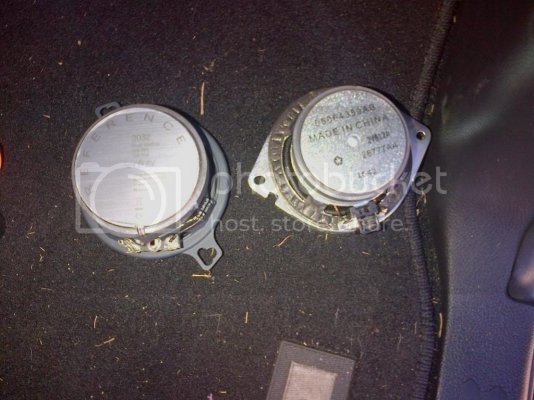

New dash speakers installed
My METRA harnesses came in this week so I took advantage of the nice afternoon and installed my new Infinity 3 1/2s. Install we really simple. Pop the speaker grill of, remove two screws and the factory speaker, install Metra harness and new speaker with factory screws. Total install took about 15 minutes. This is a must do for $70!!
Stock 'alpine' beside new Infinity
All nice and snug in his new home :)

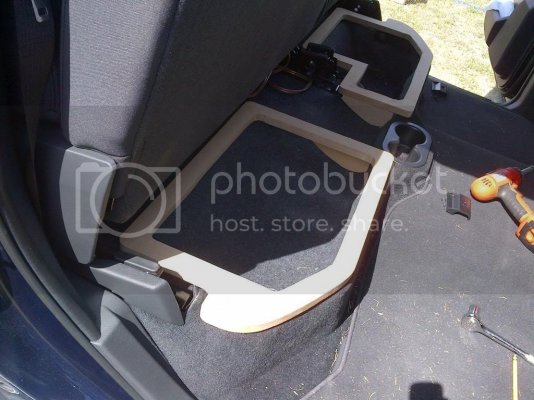

Building the fiberglass sub boxes

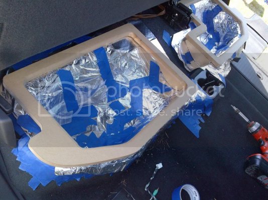

Inspired by all those that have done this before me (thanks to Myoung and many others!!!) I decided to build fiberglass and mdf boxes for 2 Infinity 10s. after much debate I decided to make 2 separate boxes instead of 1 big one.
Started with 1 overlapping layer of masking tape followed by 1 overlapping layer of cheap aluminum foil using more tape to seal the seams. Tape protects the carpet 'just in case' the foil ensures that the fiberglass boxes will come out easily.

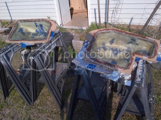

Next comes the many layers of fiberglass and resin.

It took me about 2.5 hours to lay the 4 layers of fiberglass. for the last batch of resin I doubled the amount of hardener mixed into the resin to help quicken the curing process. After curing for about 30 minutes the tubs were ready to be removed from the truck. Thanks to the foil they lifted right out :)
As the fiberglass was curing I started routing the top pieces of MDF for the subs to mount to as well as some trim rings to protect the subs when the seats are down.
(Pics to follow)
Sadly I will have to wait till the weekend before I can work on this again... stupid jobs!!!
