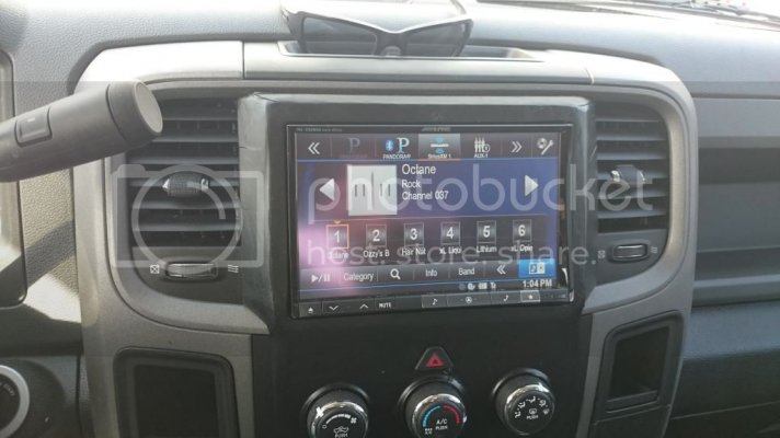

I went with the alpine ine-z928hd. I couldn't find anyone that had the perfect fit dash available so I made my own. I used a vinyl wrap but couldn't get it perfect on the corners. I'm going to redo it this spring.

looks nice.
what kind of vinyl did you use? look into a 4-way stretch with a heat gun it will go around those corners no issues. also use a good contact glue.

Just some cheap ebay stuff and 3m spray adhesive.
