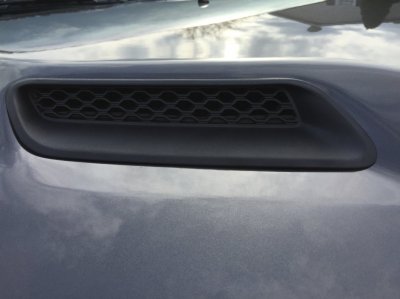

I call ********.. the "vents" on the sport hood are solid pieces of plastic moulded to look like honeycomb. Total appearance, zero function. So I don't know where this duct is pulling air from but it ain't from those hood vents.
My last truck had a real SRT10 hood on it and I did notice a slight benefit in engine temps.. i refused to buy a truck with the sport hood because it's face. Why don't I just go down to Canadian Tire and pick up a couple of those stick on fender vents too.

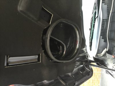

From the way it looks, it appears to make at least one (maybe both) of the vents functional and routes them to the MOPAR CAI.
I can see it working well and would like to see what's under the liner in the picture. It would be low profile and Vararam like except mounted to the sport hood itself.

I just put one on my 2016 rebel it comes with a new vent that is open to get air in from out side and yes you need the mopar cai witch I have on order when I get that it will be complete

Very nice, so I'm guessing you have to alter the liner yourself during install?
In addition, are there now two different MOPAR CAIs, one for the hood vent and one without?

Cai you need is 77070023ac
I have a v6 so I don't think they make this specifically for my truck, but I'm thinking some slight modifications will work.

I was thinking about getting this but it appears at a cost of over $600 it only supplies the functionality from one vent,crap @ 1/2 that cost theres the vararam.Hate 1/2 *** stuff & twice the price.
