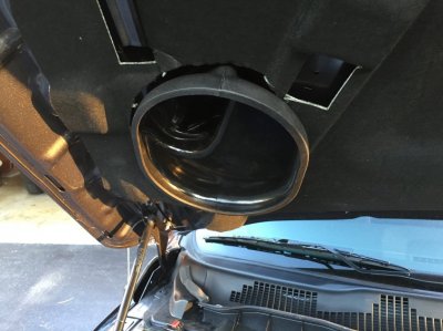

I've had the ram air intake and the mopar cai for a week now it doesn't fit perfect but it does seal good now I had water in the cai but it was when the truck was sitting there is a drain hole in the cai witch does a good job the filter does stay dry I am very happy so far.

air duct
here is some picture with cai installed it does seem to get some cold air from outside I like the set up so far.IMG_0364.jpg

Thanks for the pics! It does just use one single vent on the hood correct? No both?
