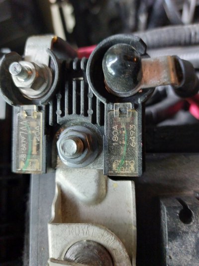

If you're referring to the inline fuse, my '21 Warlock employs fusible links for the alternator and starter motor, AFAIK.
I would suspect the 180A fusible link is for the starter and the 120A is for the alternator. I may be corrected by someone with more experience in this area.
Regardless of which fusible link is used for the alternator, a quick check with a multimeter should confirm them both as operational or not.
The fusible links are attached to the positive battery terminal, in case that wasn't obvious. :cool:
I'm not certain if your 2004 is the same if someone could comment on that?
