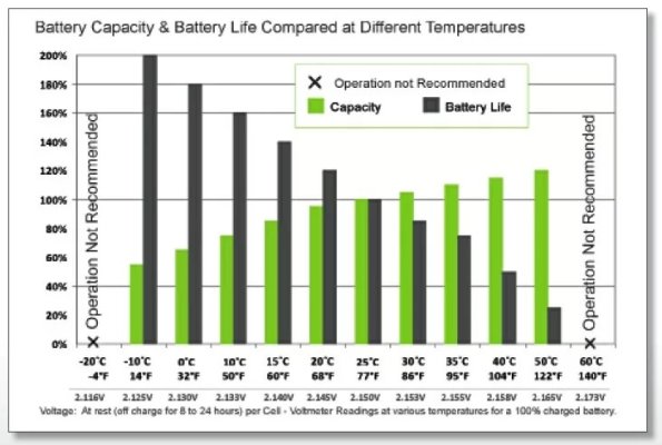

Was starter and alternator oem? Easy answer would use oem parts and new battery. Is battery over 3 years old? When weather gets down in the theirties and below battery capacity is way low, and hemi's need a lot of cca. Hard answer is a short somewhere.
