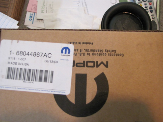

When my 2009 Dodge Ram 1500 Bighorn Quad Cab was brand new
It came with the basic latch in the tailgate
It came originally with the non locking handle
I bought the latch that came in the Laramie

I think this was the 2 different handles
I added this camera, we didn't not know that there were better ones at that time
this might have been the new handle with lock & camera
I had the dealership install the harness to the radio for the camera
I don't think that they had remote locks for the tailgate back then
