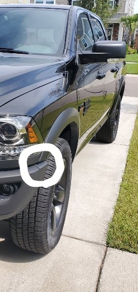

Ok thanks, my 15 was a little different in the front bumper I had to remove the headlights when i pulled it, this is a classic warlock I wasn't sure if that piece below the headlight had to come off as well, actually just watched a video of a guy removing his front bumper on a rebel which looks pretty close to this, and it looks like he didn't gave to pull the headlight or move that at all. Just want to make sure the zone ZOND9150 kit will work with this. e4f6d78a6bcf8515875e516206f82976.jpg

Are you talking about that piece right under the headlight? If so, to me it does not look like you’d have to remove that. Send zone an email and tell them you have the rebel bunper and they should be able
To tell you!
