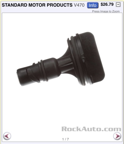

HuskerRam
Air Force
Apr 14, 2013
439
807
Tucson, AZ
3.0 Ecodiesel
As for the PCV, are these worth cleaning or should I just replace it? Rockauto does have the MOPAR PCV but again much more expensive (relatively) than any others. Are there any upgrades I should consider when doing this?
If you end up replacing the PCV, get this one. I’m pretty sure SMP makes the Mopar part. When I replaced it on my 2018 5.7 it came with the Mopar stamp on it.
