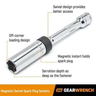

Buy yourself one of these sockets if you don't have one,along with a short 1.5" or 1.75" extension.
You'll kick your rear for not having these years ago,lol

This will make the job so much easier! Easily found at any auto parts store.

Absolute necessity. I tried doing the job without the swivel socket, no dice and you’ll just **** yourself off, maybe break some things too. Get swivel socket and don’t forget a gap tool, and be very careful with the igniter tips.

. You stole my pic before I could steal it Wild one!
