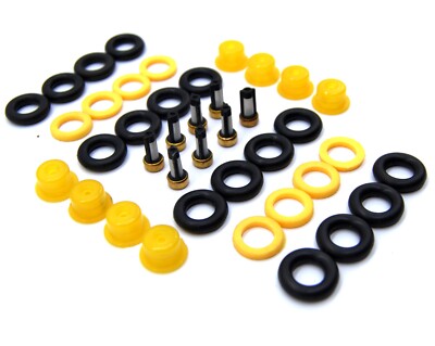

When i'm in no rush,i'll usually pre-soak them in injector cleaner,then hit them with carb/choke cleaner then usually follow up with a brake clean flush.I flush them both ways,usually do the back flush first so that anything caught in the screens gets blown out the feed end,instead of onto the pintle /seat.
I did find a rebuild kit for the 5.7 injectors that includes new screens,but so far i've never had one plugged to the point i couldn't blow the screens clean,after soaking it for a day or 2.

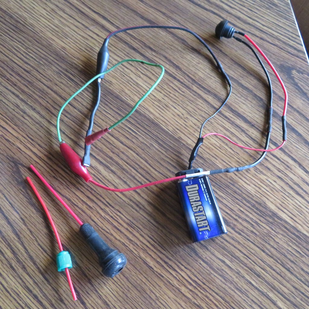

Damn cheap 9 volt batteries,aarrgghh,lol. I was gonna finish up cleaning the injectors this afternoon,and my last cheap 9 volt died ggrrr :rolleyes: Can't really blame it,as it cleaned my buddies injectors on his Challenger a week or so ago,and i should have known enough to grab some more,good thing is Crappy Tire has them on sale this week:waytogo:

These are the screens inside the injectors,maybe that'll give you an idea of why i do the cleaning like i do,lol
Other then the open weave sock on the fuel pump basket,these are the only fuel filters on a hemi
So, a 9vdc signal is enough to run the injectors? Would 12v be too much?
You could also use a small wall-wart supply (in the correct voltage, of course) to provide power.
But, I do like the 9v battery, they are probably better suited, in that, who cares if you use a new battery each time? Cheap, more portable, and you dont need to worry about finding an outlet.
I'll bet mine could use a good cleaning like this, I am terrible about remembering to run injector cleaner every so often.
9 volts is lots to cycle them Ed,but if accessing 12volts is easier it works to,i think you'd be safe even using an 18 volt wall wart,but don't quote me on that,as i've never tried it. The injector is just a electromagnetic coil so it should be okay up to 18 volts,but i'd scrounge up an old injector to try it on first
Battery is better I think. I just wasn't sure if they run off 5v or 12v in the truck. I haven't looked at that yet (as I'm sure you can tell....lol).
