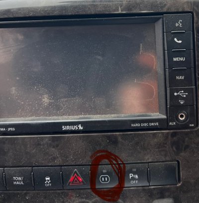

I need help locating the equivalent of this button(it’s present on 2011 ram 1500 Laramie longhorn) on a 2013 ram 1500 Laramie. My truck doesn’t have a physical button like this neither can I find it anywhere else. I want to use the 115v ac power outlet to charge my phone. But as it seems that there’s no power when I plug it in, also the little light on it doesn’t illuminate since there’s no power. How do I tackle it? Also the power outlet in the centre console isn’t working at all.

There is no button for it on a 2013-18 truck... Check fuse 38. (Check it at i420 if you prefer).
2013 diagram... See 2nd page
(The "inverter switch signal" is basically a switched 12v enable signal from the BCM that switches on the relay inside the dash outlet to pass the 110v though it. Make sure you have 110v from the inverter at the yellow i420 seat plug under the passenger seat with ignition/engine running. Also could be a faulty dash outlet, or inverter module under the seat. Any inverter settings within the radio menu?)
Driver Seat Connectors for Reference (Post 2025)
PS: make sure the plug at the back of the outlet is fully seated as well.
