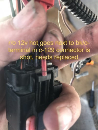

I found the 12v hot terminal toasted at the last connector before plug (C-129). Pulled it out and cut it clean and slid it into back of connector until I find a buddy with terminal tool or more patience than me to replace the terminal properly.
